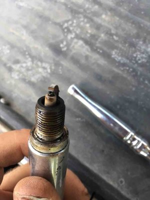

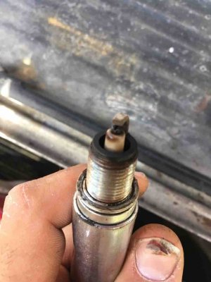

Plugs in order from front of engine bay drivers side
The oil on the threads is the leaky valve cover that I've yet to fix. Will upload a better video of the noise.
