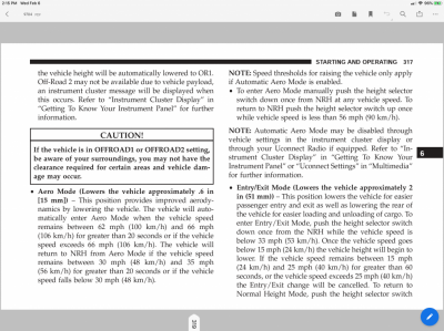

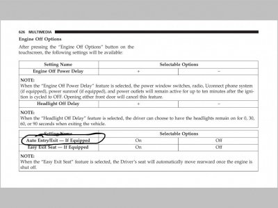

I may stand corrected. Found this on page 577 under the Uconnect 3 5” display settings. I didn’t find it listed under the 8.4” or 12” settings as listed above. It might be the auto easy entry/exit with the easy entry/exit seat setting. I don’t have air suspension so can’t test it.

Interesting for sure and some one posted this before. It most certainly is not on a Laramie at all.

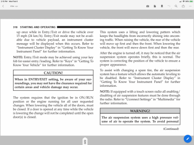

It could be this one. Again I don’t have air suspension so can’t try to confirm. It does say if you open a door before it lowers or raises it stops until the issue is corrected. See post above for page 318 about doors.
