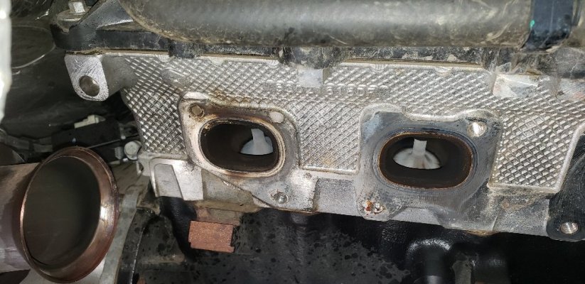

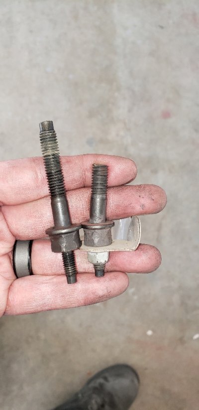

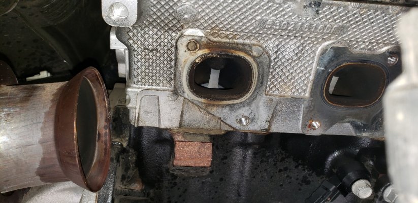

So how bad is this? Lol @the_goodguy07 definitely has a broken manifold bolt ... one that we saw on the passenger's side ...
We didn't check the driver's side but a good chunk of it is still in there ... going to try and weld a nut to see if we can get that ****** out lol ... any other way lol ... d8da415fddf24ec1a828c9043d8f9636.jpg2c9304a64a870c746cee520b3af285d5.jpg076408830edc52e7acb9df482737446c.jpg

Lol yes ... we're trying to figure out how to get it out.... hopefully that's the only one lol
From what I've read on this forum there is some trick to like welding a bolt to a nut or something. Sorry I don't remember the exact thing they did. If this happens to my truck I'll have to get someone to fix for me cuz I don't know how to extract broken bolts or have any knowledge on welding lol. Good luck man, and please post your results.
