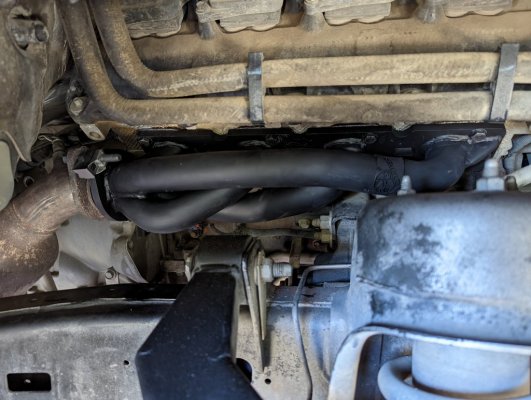

if not mistaken (I sure as hell couldnt find them) I dont think ARP makes studs for the 5.7 hemi - I decided to bail the oe manifolds and went with BBK shorties and have been happy so far with performance and looks.

I got the BBK shorties, For the price and what you get it's hard to complain i am very happy with them. The hardest part to install is getting the broken bolts out of the block. once those are out they are not too hard to install there are a couple bolts that are a pain in the ass to get to. All in all not to hard of a job just take your time and have fun with it.
