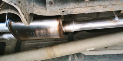

I am running the new flow master Flow FX stock from front of muffler cat's and all. 3 inch inlet 2-2 1/2 outlets no drone and in 6th running highway you just here it enough to know its got a system on it. I really like it if I want to here it more I just put it in 5th for a bit
