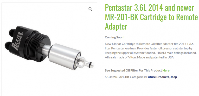

That seems to be a good unit for thermal transfer for sure. The harder problem to solve is finding a good place to tap the oil system on the engine.
I have looked at:
This is still 'COMING SOON!', but if available would allow a remote oil filter and cooler with no modification to the engine configuration.
Maybe I should call and inquire about the status. Overall, this company appears to make some high quality parts and of course charge an appropriately high-quality price.
While I don't mind paying for the good stuff.....I sure would like to have some assurance that it will work.
This project would require some time to work out the details and fab/machine various brackets and get custom lines made.
Along with the radiator you linked - this could be a workable combination.

I wonder if there's a way to tap into the oil side of the new all aluminum Doorman oil filter/cooler assembly? There's no way I'd hang that above adapter off the plastic OEM housing..
That's going to be a tough one because there's no access to the fittings for the oil cooler portion of the OEM pentastar oil filter/cooler assembly that I know of. It's ported into the bottom of the assembly and sealed with O-rings once the unit is snugged down.
You are correct in that the lines would need to be cleverly restrained to limit the pressure on the plastic OEM oil filter housing. A stress loop would probably be enough to allow the engine movement without transferring stresses to the housing.
I could machine a support structure that holds lines and the adapter itself. At least once it is installed - it never moves. The oil filter would be remote.
Not sure of any other way to get oil out/in the engine other than the stock oil filter/cooler. Modifying the oil cooler myself is a big task since I have to remove the whole supercharger system to get to it.

I have not yet recieved a response from Baxter about the drop remote filter unit they have (coming soon).
