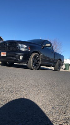

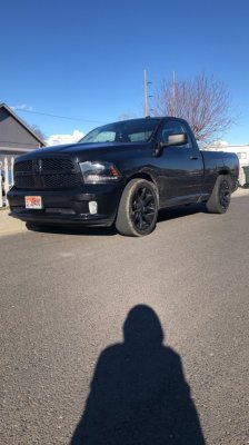

Post another pic of your truck. I love RCSB (regular cab short bed) trucks.
EnanoHemi
EnanoHemi
Mar 16, 2019
8
Umatilla
8B62CB1D-02AB-4417-93A6-347516CD7D8F.jpeg BC91770B-8F16-44A5-9120-AD6E1D50EE6A.jpeg 0F6C2FAB-07B7-4F4B-BCDA-3E573B794F1D.jpeg 6B1EC3DF-5D60-4DED-B458-8554F8360878.jpeg Here are some shots I’ve taken of it, cleans up pretty good for black paint

Good lookin truck btw.
