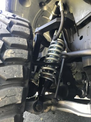

Actually found a old post when I had the 3" upfront and 2 in the rear. It measured 40 1/2 up front so I gained basically 7 inches on top of the 3" lol

Wow those angles are insane, you would think an experienced installer would look at that and think...”now something isn’t right here”...lol
My concern driving it like that would be the steering, those tie rods are at a terrible angle. How’s your brake line look?
Here’s my BDS 6" W/O the preload spacer and 6112's adjusted to 2.75 for approx 8" front lift

I can’t understand why any professional would install a preload spacer on an adjustable strut? And then let it leave your shop with angles like that. SMH

Momma always told me not to say anything if you ain't got nothing nice to say...
That being said, good luck with your cv saving goals of 2020 and beyond.

The issue isnt the bils it's the preload spacer with the bils maxed is what causes the angle

To each their own... With that out of the way, those CV’s are on borrowed time.
