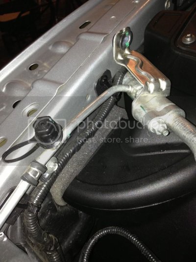

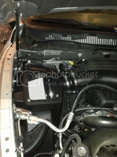

I have a 2013 and I installed the S&B intake last night. In the instructions it mentions that people with 2013's may have a clearance issue with the AC line, and to loosen the brackets so you can shift it forward a little bit. Before I loosened the brackets, I noticed that they were as far forward as they could go, so my first thought was "This should be an easy fit". However, I then lowered the intake into the bay, and I couldn't raise it up high enough for the mounting bolt to match up with the hole. So my issue wasn't a shift forward but a shift up. The top part of the air inlet tube was hitting the AC line that runs under the upper lip of the fender. I completely removed the bolt mounting the AC line bracket (the one closest the intake), I could then raise the line up high enough to mount the intake. I had to shift it up over .5", so the holes don't line up and now that AC bracket is not mounted (the forward one still is though). I don't off-road, at worst I'm on some mediocre gravel roads 2% of the time. Should I worry? It was getting late last night and I was frustrated, maybe I missed another way to approach the problem.
Here is a pic of the AC line bracket as it is now, and of the intake installed:

First off nice job with working around and getting things to fit. I know a ton of people that would've just given up. I would be careful shutting the hood with how high the shreader valve looks in that picture. For the catch can you can run a hose clap on the end you could only get .75" onto the outlet if it really worries you, that system should be pretty low pressure so I wouldn't worry about it popping off.

Nice install--I love that S&B almost stock look. :mfr_omg:
As far as the A/C line, I bet you could partially straighten the bracket you removed to still provide some support and still use the rubber bushing to protect the AC line. Your call, but with the service connection there all you need is for some grease gorilla to jam the hose on and crimp or crack the piping. It's probably fine, and there are good techs out there, but there are also a lot of hung-over clock watching hot heads, newbies and barely qualified-types to at least suggest you might consider restoring some level of support.
For the Catch Can I used a small amount of WD40 on the inside of my hoses--it made all the difference in the world. I'm surprised there wasn't a 1/2" ID nipple sticking out of your intake below the TB to accept the male/male brass fitting. If you inserted the hose over the rubber nipple, you may want to watch it a first to make certain it doesn't suck air. No big deal at WOT, but could lean you out at idle and cause a stall since it is after the air sensors. :angry94:
Maybe a little WD40 and you could make the brass fitting work? :Stupid Me:

Man, that mounting bracket is made out of thick metal with lots of gusseting.
My personal though is they don't put a heavy bracket like that on for nothing.
Can you maybe oval some mounting points on the S&B to allow it to shift out of the way?
Or perhaps you can bend the small AC line a touch to allow the other bracket to line up?
There is actually a lot of room above the intake and those mounting brackets, so it's not close to hitting anything. I was worried about that too, so I checked the clearance.

That metal bracket is really thick, so I'd have to take it out to bend it, and there doesn't seem to be an easy way to do that at first glance.

Good point about the reason for the thickness, but that also could be because they needed to support it a tad better for the spacer that is also there. I can't shift the intake down because the lower mount bolt and also it would not line up with the opening in the fender where it gets it's air. I was thinking I could try and do something with a 2"x1"x.125" piece of metal. Drill a couple holes in it at either end. Fasten one end to the original mount point in the fender and the other to the bracket that's raised up. Should work. But that's a lot of talk for a guy who has never done metal work before...lol. I sent in a note to S&B support, maybe they've seen the issue and/or can offer me some guidance.

The intake looks great. Easiest solution is to just slightly bend the bracket so that the mounting holes line up to the fender. I do know a few guys that just left it as yours is, and it has not shown any problems. I would just try to bend the bracket though for peace of mind.

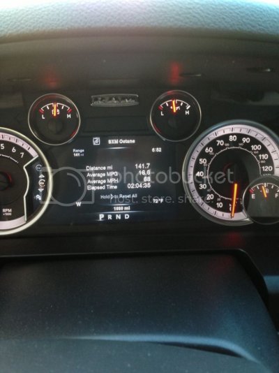

Drove up to the cabin, 2+ hour drive. Impressive results in terms of MPG, haven't checked the catch can yet. The first picture is of a return trip a couple weeks ago that was done on a Monday morning (just went straight into work). The second picture is last nights trip (went to the cabin from home after I got home from work). Based on the price of gas and how many miles I put on my truck in a year and I get an ROI on these mods in under a year.
