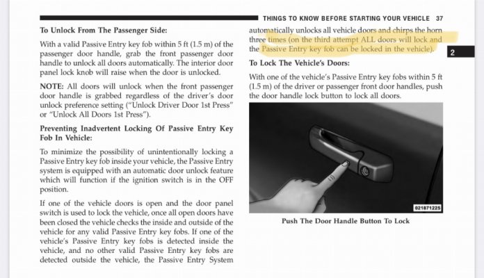

Many of the higher trim level trucks are equipped with the Fobik safe feature which prevents you from inadvertently locking your keys in your truck. His truck would unlock itself even if he manually pressed the lock lever as soon as he closed the door. He's trying to figure out how to purposely lock a spare key in his truck.
