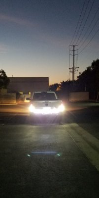

Law schmah......
Led tow hook pods
Led fogs
Led behind the grill led pods
Led lows
