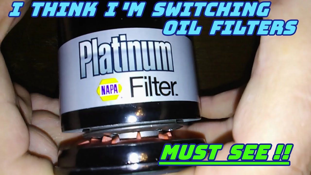

This looks like a great filter to me. Might give this a try .
Burla, any thoughts?
A top choice for sure, which ever clone you like RP/Amsoil EA or Wix xp/Napa platinum, top of the roost, just a matter of personal choice there. We know synthetic media lasts longer, and in fact will out last any oil, but the one thing the GM test proves if nothing else is that spun microglass will also filter better, which is what was new information at that time. We know puro boss is also top choice AFTER it's redesign. And we always need to stay on top of the information because it always changes. And the good ram forum member who recently found this info on fram ultra is a perfect example, I liked ultra and used them on our other vehicle, I'm done with it, they wont get my dollars anymore.
