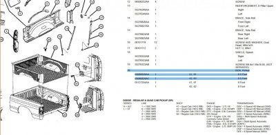

Hello. I would like to know if anyone can help with info on my 03 2500 5.7l auto 4door 6.5bed frame. Seeking a used one because the amount of work needed to restore this is not worth it to me. Question is : What years and models can be used. Any info would be greatly appreciated, and any info on prep , paint, and a rust preventer? Thank you

You can't open the picture?
I didn't attach the entire parts document
just that picture that shows the only two part numbers for 6.5' bed
