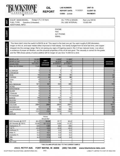

I've run Redline since the odometer read 15,000 miles, it now has 36,000 miles, so I'm not sure how dirty or clogged up it could be.
I do think its heavily temperature dependent, today I got it hot enough to hit 165 degrees before shutting off this time, and it didn't happen today. Last time it happened few days ago it was only about 118 degrees and I got the rattle.
It is truly baffling, because while it happens when the engine is turned off cold, it never once happened when the engine is turned off hot. I don't understand mechanically what the difference is, if oil is leaking out of the lifters causing too much lash, why does it only happen when cold and not hot?
That's also why I don't think it's dirty related, but what do I know lol.
Below is my latest UOA (units are KM's on that report, not miles), it started doing it on this oil in this report, as the weather became colder in late Oct last year.
