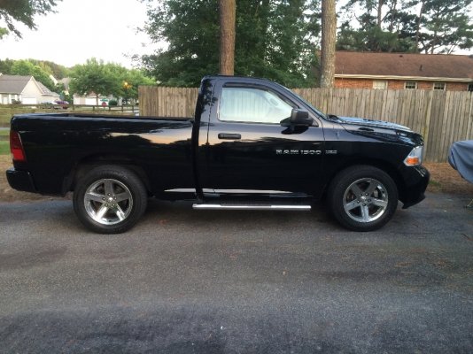

I am looking for front coil springs to replace the ones on the truck. I have 161K. Ram conveniently does not make them any more. Front coils springs should be part number 68049030AB with the last 8 digits of the VIN being CG179404. Ram says they still make the front shocks 68040872AB, rear springs 68042806AC and rear shocks 52855791AD.
I do not want to raise or lower the truck.
If you go onto MOOG website and put my truck info in there, they do not make a specific front spring for the truck.
After days of searching the internet for hours each day, I think I have determined there are NO replacement springs on the market for stock ride height. Makes me mad. I love this truck. Hate to send it off into never never land. Wont be too much longer and safety becomes a factor driving it on the roads and the springs continue to wear.

I do know sag is measured not from the wheel well but from the suspension. It shows 1.75" sag. Truck has 161K on it. The truck is a 2WD and does not have a strut suspension.
Not sure how you're measuring but keep it simple how much space do you have from ground to the fender edge in the middle? if you can't find springs you can just add a spacer to restore your original heigth. In your case a spacer is cheap and it doesn't hurt shock travel or anything since the spring has literally shrunk some.
