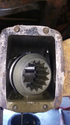

Erm.. you're not supposed to be like that...

Well maybe it's just because I already have the other shaft out
Idk of it's different on a 44 but it takes a specific angle to get my collar in and out so for it to have been like that idk lol, check the play in the inner bearin yet? What about the bushing in the end of outer axle shaft

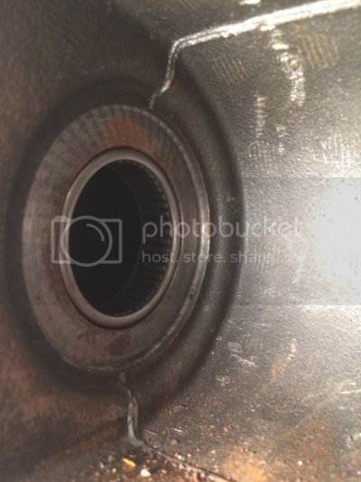

Inner bearing on the diff? How should I check that? I was about to pull the carrier if I can remember how. And what bushing??

This all looks good to my eyes

When you pull the inner axle out there's a needle bearin on the left side of the CAD housing looks like this,

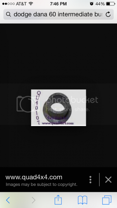

And then there should be a bushing that slides over the end of the inner axle, but is pressed into the outer axle. But yea it looks good, I don't see the problem beingn in the actual axle yet lol

And you remove the Carrier by just unbtin the four cap bolts and then prying the carrier out

I'll check that out. Left as in towards the chunk or towards the wheel?
And the bushing you mean like what the shift fork moves to engage 4x4?

It's toward the axle, bushing is in between the two passenger side axles looks like this 026D9488-B8AC-484A-A8A4-8B6B24F9FAB6_zpsbg2xdnyj.png
