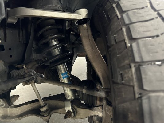

I have a 2013 1500 with 60,000kms. After installing Bilstein 5100 and bags in the rear, the front sits slightly lower. What is the best way to fix this and level the truck nicely?

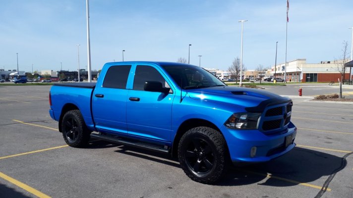

Here's mine with 5100's all around set at 2.1" height on the fronts, and with stock springs all around, too, and sitting on BFG KO2 LT285/65R20's - pic from last summer.
I'm now rolling on Michelin Defender LTX M/S LT295/65R20's and like it even more.
