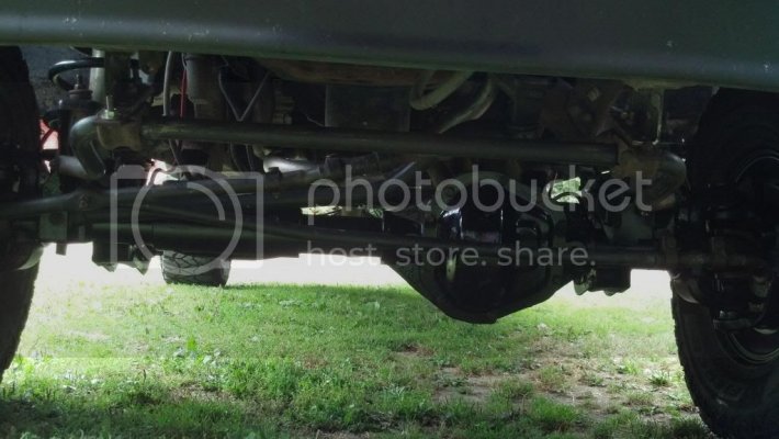

Who here with a 97 +/- 1500 can get me a pic of theirs mounted? Mine never had one when I bought it. Picked one up (already off the donor rig) and am trying to figure out how to install everything.

The sway bar should mount to the frame with the donor mounts, but you'll need end links for your year of truck.
I don't know the changeover year but earlier 2nd gens had studs on both ends and later years had the ball stud on the lower mounting point.

This is the frame side (note there is a 2" spacer in there for my lift) This may or may not help you.
Side view

That helps Merc thanks. Also, can you get me a pic of one of the end links? I'm trying to tell what mine is exactly.
Okie, how can I tell if I need the extended links or not? There anyway to tell if I have a factory lift? Cause I know my 33" tires look small in the wheel opening.
