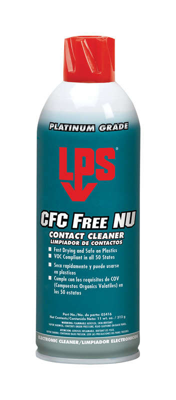

Buy a can of either of these
either can be used to clean up the Towing wiring on your rear bumper
