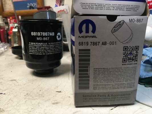

So, I purchased a filter set off of Amazon and at first review it appeared the seller was the Mopar store. Everything was packaged perfectly. Replaced the water separator filter first, no issues, then the fuel filter. Primed a number of times and nothing, no start. I pulled the cap off of the fuel filter and no fuel. Thinking what I read so many times about the bogus parts I swapped back the old filter and water separator, primed and started no problem. All markings look perfect I really don't think they're counterfeit just a failed filter. What could really be bad with a filter that it wouldn't allow fuel to pass?
The event also tripped a code for low fuel pressure. After more review the parts were shipped through a parts wholesaler.

There's a few other threads I posted about this with pics of what to look for. The issue I've found personally and with other members here is the rear water separator that has a probe in the center of the opening that is not high enough to open the check ball that is in the housing. It will not allow fuel to get to the secondary filter on the engine.

Thanks for sharing the info. I'll check the depth of the valve for the OE to the replacement filter. I bought filters from the dealership and if you compare the Amazon units the packaging and labeling looks identical. I'll look closer and see if I can find differences.

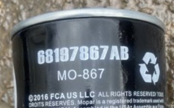

Here are two pics . Top is OE Mopar. Bottom is the fake. Note the appearance in the Recycle symbol. Along with the part number font is off. Lastly the OE top crimp ring is painted, the fake is bare steel.

You are absolutely spot on, the poppet in the filter is ~ .180 deeper than the known Mopar filter. I don't know if that validates it's a bogus filter but it sure is defective. The only details other than the poppet are labeling on the filter and the box doesn't have a mfg date.
