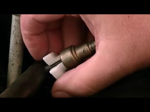

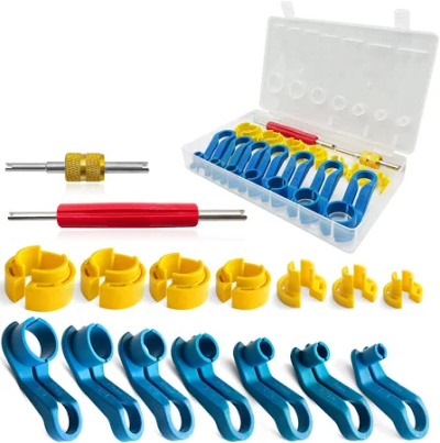

that fuel line tool is better than screw driver & pliers
even the cheaper tools work
Actually the release for the pump line is kind of a pushbutton style. There is a u-shaped (ish) locking clip that was missing.
It must've come off when the bedside was repaired when I got hit in a parking lot a couple years back, the body shop did have the bed off, but they didn't have to mess with the lines, except the filler neck.
I got the fitting to release by hand, but it did take a bit. If I had been trying to get at it from underneath, I'm not sure if it would've released.
