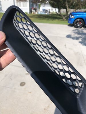

Phase II:
The open hood scoop had a considerable amount of casting flash. I spent some time with the Exacto knife and #11 blade to clean it up.
The instructions said to pop the original solid scoop out and install the open one first thing. I ended up doing the scoop install close to last as fitting the plenum was problematic to a degreewith the new scoop in place, at least for me. With the plenum semi installed the open scoop went in without issue.
I opted to remove the hood insulation blanket in total after semi marking out the cut out zone in chalk. Easye to work the shears on the bench then the truck. I may alter the cut out for a more custom fit.
The plenum mounting takes a bit of head scratching to get the components in place. At first go round it was like “no way will this thing fit between the hood and the support structure”, but it does with ease (once the new open scoop was removed which gave up just a bit more space to move things ).
The bolt that fits in the plenum filter opening is 60mm’s long. I found it was a washer thickness to short, so left it off pending a re-fit tomorrow, or a thinner washer. It (the bolt head) is just visible in the pictures.
T.
