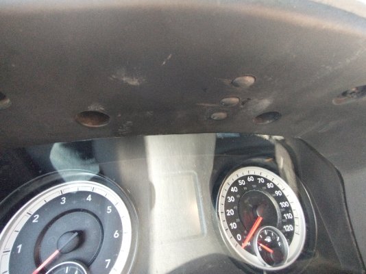

Or you can be sneaky and hide one above your guage cluster.
Make it so its only powered when ignition is on. Keep pesky burglars out of your garage.6b95dba3ef17fb4e6cd819d15f075846.jpg
Now that is pretty ingenious. I wouldn't even know where to start though lol

Its from a volkswagen.
Just troll a junkyard and find the thinnest homelink you can find in a visor. I think the visor cost me $5.
Be sure to take as much harness as you can. Its only 2 wires + and -. Hook that up to an ignition source
