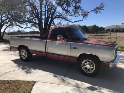

Hi Y'all,
First, I'm brand new here and looked for wheel/tire info and couldn't find it. If this is the wrong place please help.

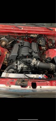

Next, I'm working on a 1988 Ram D250 2WD Long Bed and looking for age appropriate looking wheel/tire that will fit under the fenders and PROVIDE TRACTION as what I have is sorely lacking. I like the wheels that are on the truck, but they are simply overwhelmed by the power combo.
6.4 Scat Pack Hemi and 8 speed auto swap with 4.71:1 (first gear) and 3.:92:1 rear gear.
Last, any advice/tips would be appreciated.

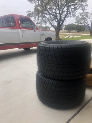

Thank You Sir, and yes, I want to stay old skool'ish if possible but this thing has issues for fitment. It takes 18" wheels to clear the front suspension, but that's kind of the wrong direction. I don't like the daily ride of drag slicks, but they stick better. I was going to make it appear like a dually with a super single tire in the back, so I bought 18"5" wide Mickey Thompson ET's before my wife said she hated the look! :). This truck is F A S T with the swap and the 8 speed auto is sheer perfection. It is absolutely faster than my TRX and I beat a Gt350 Mustang recently in multiple pulls by 12-15 lengths. It's very much a sleeper, but will change lanes if you gas it at any speed up to 80 mph -- so, I gotta do something!

To be clear gents the big tires pictured were when I was pursuing a 'dually look' which would put the tire way outside of the bed and would need a fender to cover it. They'd just look like dual wheels. I have researched narrowing the rear axle and tubbing the bed to get those inside, but that's about a $5K no matter how you slice it, but would sure look awesome. My original question was about a new set a wheels that would fit under the fenders without mods.

if you're not lowering the truck, you could probably fit the tires in 'faux' dually mode without rolling/cutting the wheel arches if you adjust the bumpstops down farther to hit before the tires hit sheet metal.
with all that power turning all that rubber, any concerns with axle wind? old mopars used to use pinion snubbers or an extra leaf in the passenger side stack. or you could go old school and put some traction bars on the truck!
