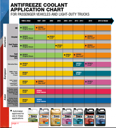

Don't use dex cool eventhough that is what chart says, yours is a dex clone, but not the same. Just use oem fca 10 year coolant, and choose pre mix or full strength.
