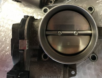

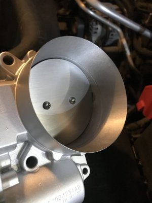

Is that true bore or tapered? Can you put up a pic of the blade open?
86mm tapered to OEM machined bore for throttle response with the ~4mm of WOT increase from half shaft. Plenty for ~500whp. Backside is polished and intake matched.
Just wondering by intake matched do you mean the backside of the TB reds to be cleaned up to match the intake opening?
Tim Garceau
Banned
Jun 29, 2018
2,090
2,413
Eagle River
2014 Sport Quad BSP
3.92 8 Speed 5.7 4X4
~$180 +shipping there, turnaround was under 2 weeks.
The factory 5.7 intake usually has molding flash that was cleaned up along with matching chamfer in the TB.
They port 6.4/5.7 intake manifolds as well.
