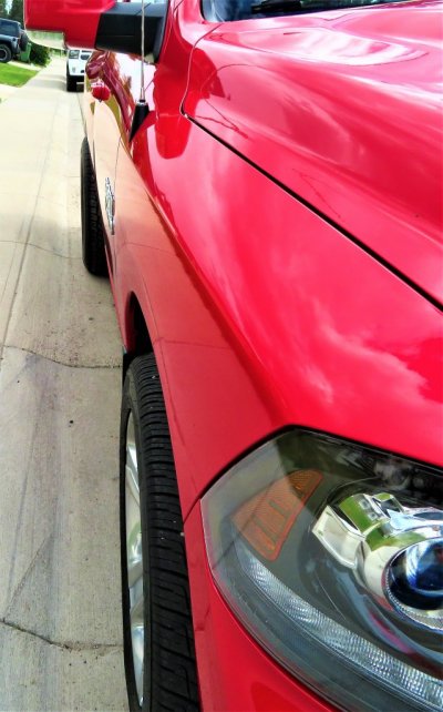

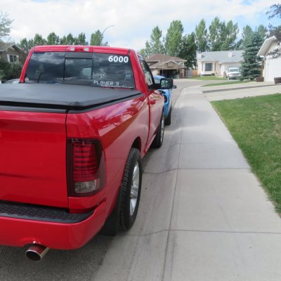

I run a 305/50/r20 on a stock rim and love it. Ther is a small rub at full lock, but I don't notice it. I love the stance it gives the truck and the look gets compliments more than I'd ever thought.

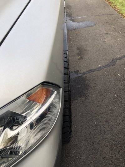

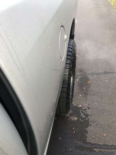

Also the look you desire and how to get there may be dependent on whether you have fender flares and if so how big they are. I have no flares and this is how they sit in my wheel wells.

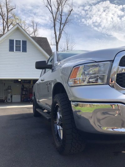

305/50's on rear ,295/50's front on the stock 20" rims
