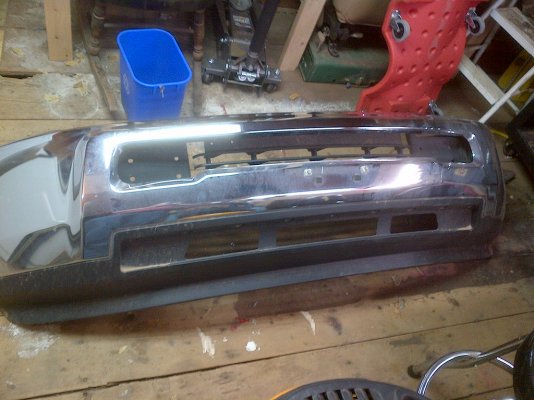

well the bumper is dirty, and it looks like i took the picture with a potato...but here it is...

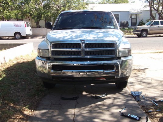

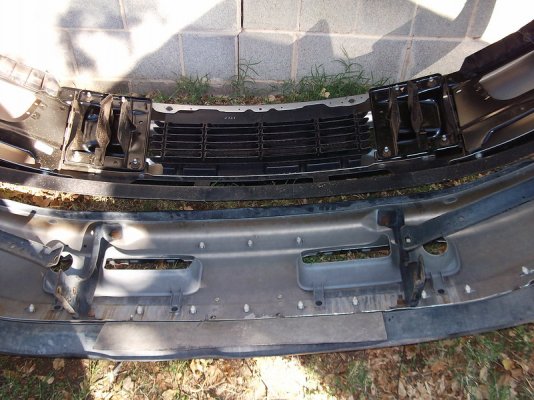

ok guys, got some pics uploading to flicker right now. taking a break after my first mock
up.
naked front end

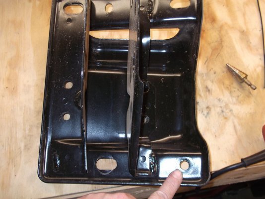

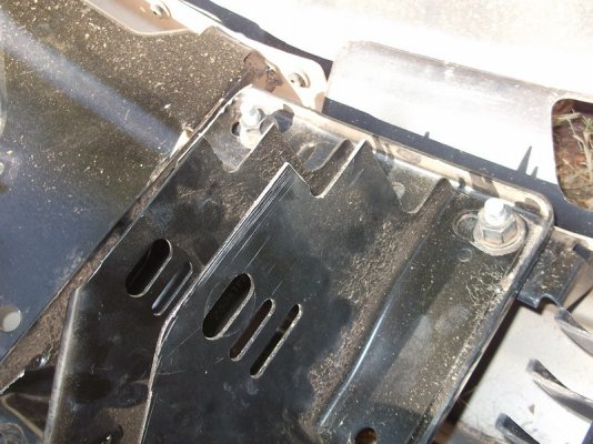

here you can see the difference in the bumper brackets. the old bumper mounts are 36 1/8'" wide. the new brackets inner most mount is 34 7/8 wide.

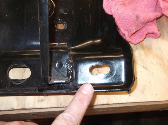

fortunatly mine cam with factory brackets, but some holes need to be enlongated so we can spread them apart a bit.
and here is one of em.

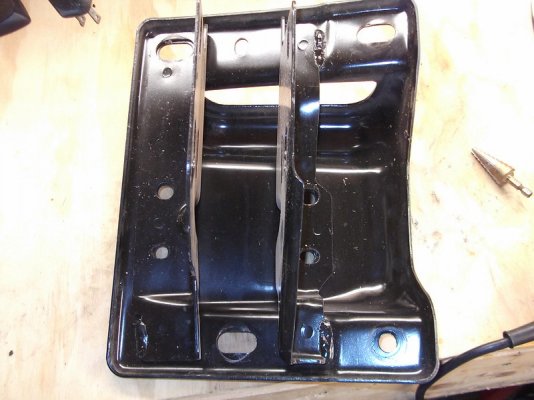

drill a pilot hole next to it, and use what ever you have to connect the two, i used a combo of cut off wheel and dremel
after

ok im hit a stopping point... im out of plate steel...need two L brackets. will have to wait a day or two till i can get to the supply place up the street.
final bracket shape.
final bumper gap.
