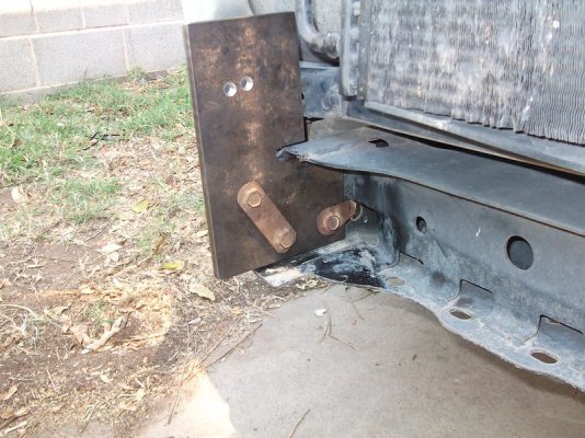

BeauDuke01
BeauDuke01
Jul 10, 2012
426
158
2001
5.9
heres the bracket, crude as hell, but it works.
side shot
the front does have a gap between the grill and bumper, but the sport grill sticks out a bit more and should fill it in better
BeauDuke01
BeauDuke01
Jul 10, 2012
426
158
2001
5.9
i used all factory mounting hardware on the bottom, and used 1/4" grade 8's to bolt on the bumper
