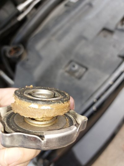

I got this gunk in my radiator cap. Im guessing mixed coolants. Whats the best procedure to clean it out?
I jist had cam and lifters done spring of '22. O had several issies with the mechanic and my truck so i drained the radiator because i figured he only put water in it. It did have an orange tint but looked more watery to me. I think i put in whatever is recommended but i cant remember. I did that about a year ago and i havent had any issues yet. No overheating or anything. Now i just decided to look in the radiator and i saw this.

Somehow a different type of A/F was mixed into your system, your model year called for HOAT type antifreeze, probably OAT was put into your system, you need to do a complete flush and put the specified coolant in your system, what's in your owner's manual, use concentrated A/F and mix 50/50 with distilled water.

Flush wont help, flushes (water) and coolants do not contain detergents, meaning you will have fresh coolant but also slime still in system. The best thing to do is run 32 ounces rmi 25 through it for 500 miles, then do your flush with distilled water. It is sad how stupid some mechanics can be with coolants. Whatever slime is in the system will get trapped in the over flow, just take a wet dry vac or similar and vac it clean. Once a system is shot like this, I might consider moving to universal coolant such as peak global life. I like using oem coolant until a system is blown, once it's blown for whatever reason it will be hard to get back to fresh. Then I would also move to a 3 year interval at most. Get a new mechanic, my guess he used a dex clone which is about as bad as adding sand to hoat.

Yeah i plan doing a better flush than just adding to it. Im just not able to right now and im bout to make 200 mile trip home. I added a little less than half a gallon of distilled water just to maybe help, the overflow hose has a blockage in it also. Luckily its 45 degrees out. I havent broke 200 on coolant temp. I ditched that mechanic right after he did the cam and lifter job. I had several issues after i got my truck back to the point i took it back, showed him all the issues. He said he would make it right and i told him no thanks, youve cost me enough allready. I do alor of my own work, oil, brakes, ac compressor, belt for what its worth, charged my own ac as im a licensed hvac tech, exhauat manifold bolts and im sure ive left a few things out over the last 8yrs but the cam and lifters was to big of a job for me. But i will get the rmi-25. Do i need the full 32oz?

I've done the RMI on my 300C basically twice now. The first time i added about 10 oz's ,and when i cleaned out the coolant tank,i was amazed at how much casting sand the RMI had loosened up,i put it all back together and added the rest of the bottle,and today i cleaned it again,and just had slime. Both times i did it,were just before making a 500 mile trip. All told i've added 32 oz's to the system
I have to admit Burla is onto something,as i'd never really heard of RMI until he started mentioning it,and it does appear to work pretty good at cleaning up cooling systems

I looked at RMI, and it looks pretty good. I have successfully used Oxalic acid in the past, but it is very toxic and requires massive neutralizing flushes with Arm & Hammer, and many gallons of clean water afterwards to prevent acid damage to radiator, heater core, head gasket, etc.
The RMI looks much better!

Yeah rmi is non toxic, which is cool. They use distributors so it was never available widespread, which is tragic. But it is so effective I can imagine how many times radiator shops charged good money for a special "treatment" and literally fixed the issue with this stuff. It is getting harder and harder to find, I'd bet most local radiator shops either have this on hand or can get it.
Some of the pricing out there is stupid, that 80 dollar deal for 4 32 ounces, it doesnt get any better then that. A lot of places are like 50 bucks for 8 ounces, lol.
