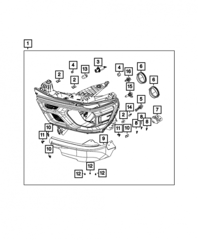

Your truck has a H11 low beam bulb and a 9005 high beam bulb.
The high beam portion is the dark area on the lower left of the diagram drawing. (near the "10").
