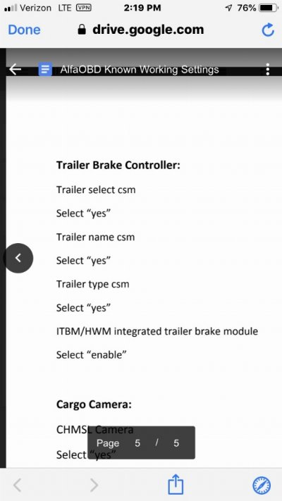

Skip the dealer and get AlphaOBD and you can activate it yourself. Installing the kit is easy, if you skip the bolts that come with the kit and just use zip ties through the mounting holes. The bolts are nearly impossible and one of them actually is impossible. Wrap the bracket with electrical tape where it makes contact metal to metal to keep everything from rattling. Check out the AlphaOBD thread for explanation of the software and how to enable the ITBM.

I recently installed the itbm and was able to get all three screws in the bracket takes some time and two people but can be done. Now just have to activate it so it shows in the evic
Where is that in Alphaobd?
