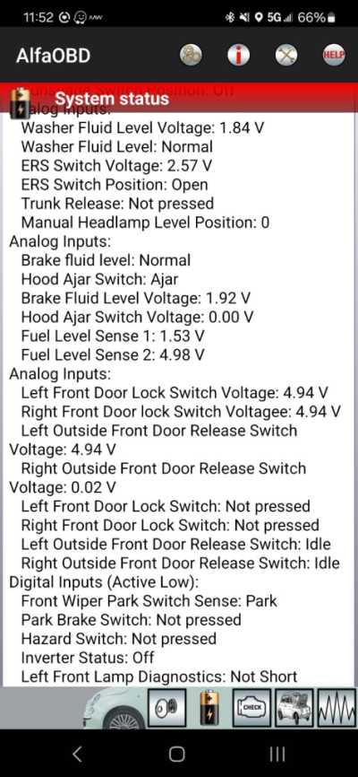

Does Anyone know why I would be reading hood ajar and 0.00v when I have grounded C1/A Pin 11?
Corrected my problem and just wanted to post in case anyone else had a hood ajar warning after only grounding pin 11 and not doing the full wiring. It appears after setting this the BCM wants to see a voltage change on the ground or else it just sets it to hood ajar. After disconnecting pin 11 from ground the voltage went from 0.00v to 2.76v. I still received the hood ajar warning but the reading said the hood was closed. I then set it back to 500/500 and the truck successfully remote starts.
