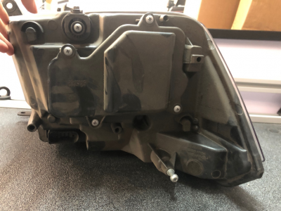

I have a customer with a 2016 ram 3500. His current headlight is the projector style, and smashed. When he went to order a new one he realized the connectors on the back are different. I have posted pictures of the one that is on his truck and the light from rock auto ( he has also purchased a head light from the dealership and the backing was the same as the one from rock auto)
( this is the head light off his truck)

That is correct, they look like modified street or alpharexusa headlights.
It looks as though he had from factory the quad headlight and upgraded based on the back. They are not a true projector but reflector style housing.
You would have to install a factory quad headlight as attached or order modified street replicas as attached in the post above. Basically this truck did not come with factory projectors.
Can you take a pic of the current headlight from the front? Preferably one if it isn't totally destroyed.
