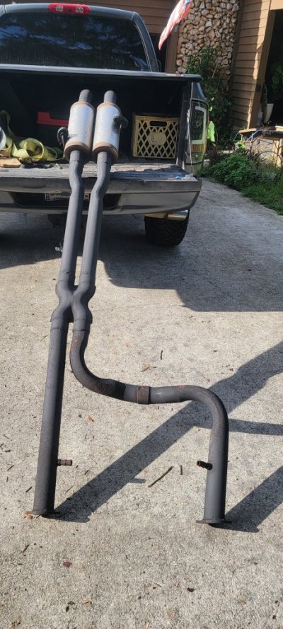

Lt with 3" duals all the way back x pipe and magnaflows is my set up...... once I get my motor in my truck.

I have this setup on my 2011 Ram 1500 5.7 Sport. I have the 2.5” though with dual super 44s, x pipe, and 5” tips running out the back end. I’m changing the LT headers for a better brand and may go 3” instead of the 2.5”. $400 difference from my exhaust shop. Plus she’s got the TSP stage 2 cam.
