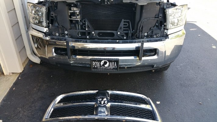

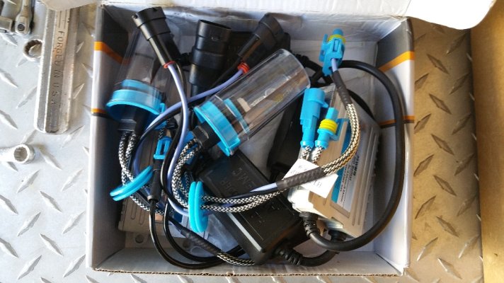

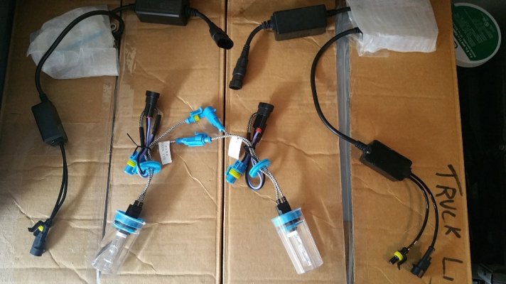

I just this week upgraded my '17 2500 Tradesman quad non projectors to HID's.
www.headlightexperts.com
35 W kit was on sale for $69.99 for just the Low beams. I already put LED's in last year but the lows still weren't great. Hi beam LED's were really bright.
So, now I have HID Low beams 5000K & LED High beams.
5000K is the closest you can get to pure white. 6000K is getting bluish and produces less useable light.
It's plug & play. Very happy with the quality of the components.

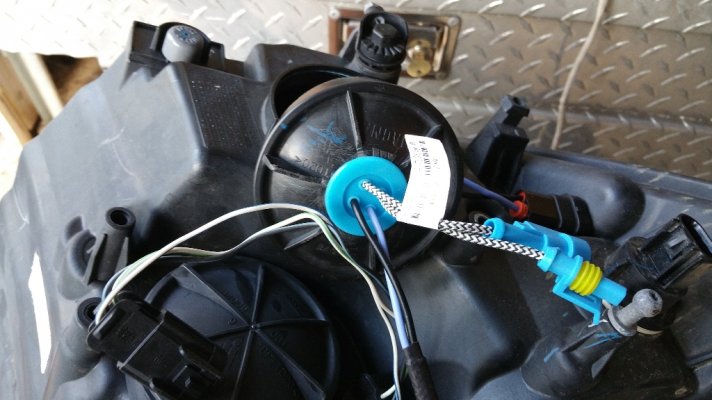

They strongly advised against 55W. Said I might have an issue because they throw off a lot more heat. He also said there is really no increase in lumens output.

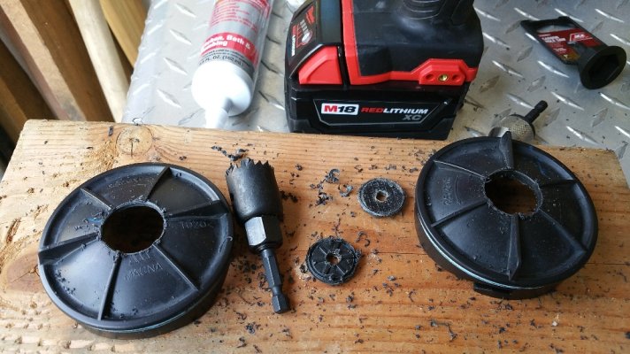

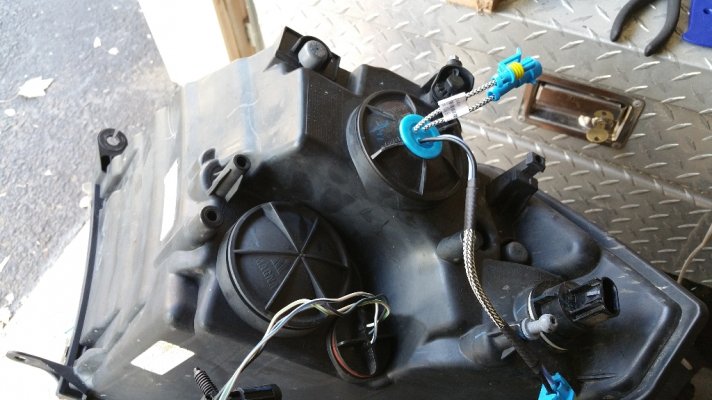

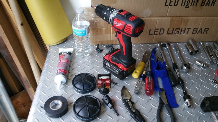

Had to use a 1" hole saw to allow the blue silicone to be inserted in the caps. Easy to do.

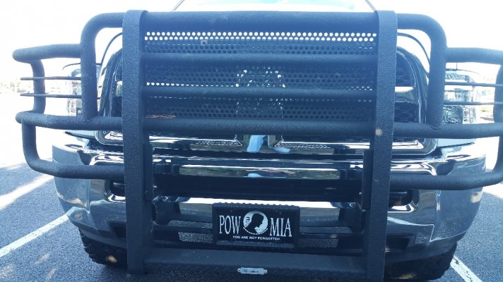

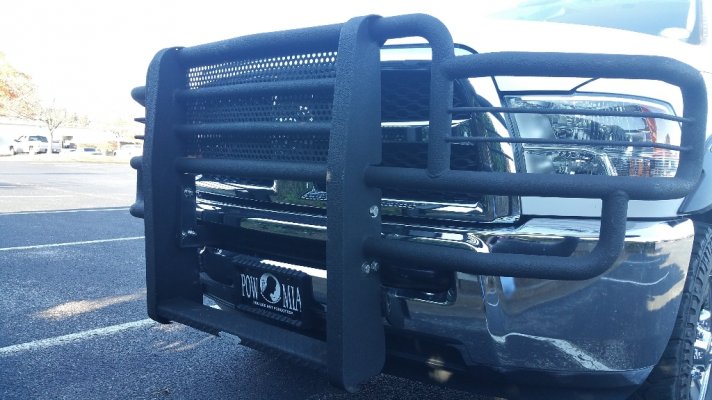

Since I had the grille guard off, I replaced all the rusted mounting bolts, nuts & flat washers with Stainless steel. That **** is pricey!
Good luck bro!32f8da073594802aed57183fa4efa7ce.jpg9b52f3ad3bf149b53b4b561f0630b9d3.jpg25a1f5078561aea8033d82bb271840ee.jpg1b8cc8a4cb2416b9a3b1d4eaef9c34b5.jpg045843a500582548ba6f828c2bb74c5c.jpge8dfb79ee4632a7e6a0a0ae85c42d1ec.jpg19dba7362cee15b0f18206ab8cbf9065.jpg6d98ba09cd3ee4caa1134d729766496f.jpgeed871f28652126a659135cbc6eff60c.jpg3d75bed4c14ea98fa1db1ceec6c517bd.jpgc5adf4e26d9e99a3a9a30671d2889913.jpg

Did you get the 35w canbus ballasts and the power relay and the warning light cancellation harnesses?
I'm not a metallurgist, but I do not believe that the stainless hardware has the same strength as something like a Grade 7 or 8.
Yes, the Canbus is part of the kit, but you may or may not need the relay. I had a problem on another truck. Needed the relay so I would be feeding power straight from the battery, not going thru the trucks wiring harness. Relay fixed that so I just put it in this time too. Relay was extra $22. All plug & play. I'll try to snap some night pics.
RodeoGeorge
There are 3 bolts that secure the bar (110 lbs) to two flanges. The flanges are secured to the truck by the 4 bolts holding each tow hook to the frame. There really is no need for Grade 8 bolts. What I removed was Metric, marked "8.8". That is approx. equal to Grade 5. It ain't going nowhere. LOL.

Do you need the relay harness For them to work?
No. But, some people do have issues with the wiring system in the vehicle supplying insufficient voltage to the ballasts which can cause the HID bulb to flicker or not light at all. I had that problem on my '09 1500. I put a relay in, which supplies 12 Volts directly to the ballast from the battery. That fixed it.
Based on that, I ordered one for $22. and put it in my '17 2500 just in case. Done. I don't have to go back in to do it again.
I know it's not difficult to remove the grill and headlight assemblies, bu I have that monster 110 lb. grille guard that must be taken off also 'cause the headlights wont fit thru with it on. I'm working out of a damn appartment bldg that frowns on any vehicle repairs too. That's another reason I put the relay in. I'm also 60 yrs old and tired of lifting heavy crap. Lol.
