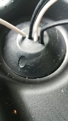

Odd my factory subs wires are not that color, trying to figure out L and R for sure. Should I use 9v battery? Here is picture of my wires to sub.
In the 13 it must be different ?

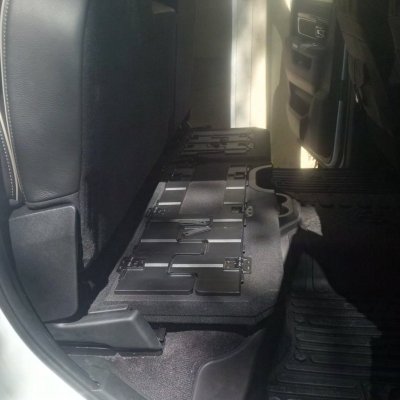

You should have been able to run of the sub wires to the amp. Perhaps that amp can't handle that much. Audio control LC2 will take the factory sub signal and give you RCA to your amp as well as reduce the roll off the alpine amp has to the sub, but your line converter should not have blown. Sub sounding like crap with an 8 in the factory enclosure with that amp you'll struggle to get much better than the stock performance. Also the sub will smell a little when breaking it in, but trying to get too much out of it and feeding it power past the clipping point will burn it up. Lots of guys keep the alpine amp and swap the sub for the pioneer shallow mount sub. Once again with that enclosure you won't get great bass. As far as getting good bass and keeping the load floor. It's a tricky endeavor. I pulled it off, but it's not perfect and it was pricey. If you're handy you could try to build a custom fg enclosure with a sub that requires minimal airspace such as a Sundown SA-3 8" or JL audio 10TW1 like I have a pair of. I'm convinced that either of those can be fitted under there.View attachment 128565 View attachment 128566 View attachment 128567 View attachment 128568
looks factory nice JOB:waytogo:
