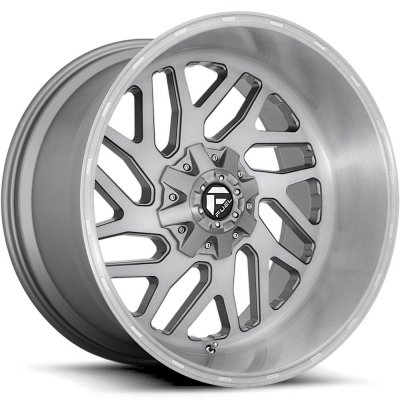

You won't find a 20x12 with a -25 offset, they usually only come in -43, -44 and -45, you can find some with -18 and a +13 offset but the only wheel I have ever seen with that offset in a 20x12 is the fuel triton below which also comes in the +13
https://www.customwheeloffset.com/b...popular&dia=20&width=12&offset=-18&brand=Fuel
https://www.customwheeloffset.com/b...ular&dia=20&width=12&offset=-18*13&brand=Fuel
Also the RBP Stealth Power running boards come in an extended version which drop down an extra 6 inches which would make the 7" maxtrac a better choice in my opinion and you can then run up to 37" tires with 20x12 wheels with a -44 offset like I am running ... yes I had to trim a bit from the bumper and pinch welds but it takes maybe 30 minutes to do so and it looks killer my friend ....
