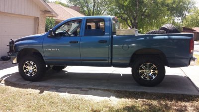

Just gonna throw my 2 cents out there, I have installed 3 Rough Country 6" lift kits on 3 different trucks and never had any issues. Last was on my 2002 Dodge Ram 1500 and I was running 35"x12.5"x17" also with no issues. I did install them all myself, it really isn't that hard, just get an alignment as soon as you put it back on the ground.Do make sure to get the correct backspacing for the wheels you want to run. I ended up adding a 1/4" spacer because I bought the wheels and tire before I installed the kit.
Here is how it sat, nice and level.
