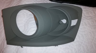

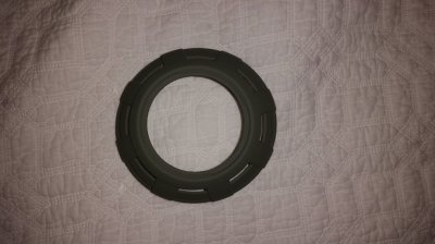

Got it all apart, primed and opened up the socket.

got everything painted but I'm having trouble getting it back in the lens. Gonna practice and then touch up. Next time I'll just pay JJ, cause this is a PAIN.
