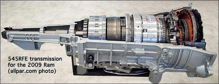

Can I turn my 545 into a 65? Because I would like that, my issue with the 545 is the 3rd and 4th gears paired with the 3.55's have really low rpm's in 3rd and 4th gears. Anyone know if you can charge the 545 then?
Yes. In the tune there a simple toggle for allowing the 2-2p shift. It won't really do much on it's own, but it's nice. Adjusting the rest of the shifts is where it's really nice and you can spend weeks fine tuning.
Those RF trannys are related. I wouldn't get caught up in 5-spd or 6-spd. I have vehicles which have 4, 5 and 6 speed tranny's. They all work ok. Yer not going to get 100mpg with any of them. Yer talking shades of gray in economy, which are easily mitigated by your driving style. I'm pretty sure all the 2012 Ram RF's were 6-spds, or the ones I've seen were.
What people don't always point out, is the more gears ya have the (often) more lag there is when you go to pass someone ...dead-spot during downshifting in many cases. On our Jeep GC with a 5-spd, on the hwy, it almost never needs to downshift to pass. Boom, the power is right there and yer around that slow turkey before they knew what even happened!! he he
The ZF 8spd is excellent at picking the right gear when you boot it. The RFE will kick to 1:1, then after a second it'll drop again into it's passing gear of 1.67:1. I chose not to number the gears as in the change from 545 to 65 (purely marketing ****) they stopped using the 2 prime term and instead just numbered the gears all in order.
Fun fact, the RFE trans' had all six ratios in place and possible way back in 99 when they first installed it in the grand cherokee.
Don't know if you can you can do this. Common sense says a custom tune could be written. Iirc, the program involved a “2nd prime” in the way 2nd gear was used. I recall thinking it was a gimmick to be able to say it was now a 6 speed. It’s been awhile so memory is a bit hazy. Interesting that you don’t like your set up, I loved my 3:55 rear and 5 speed combo in my 11 sport.
