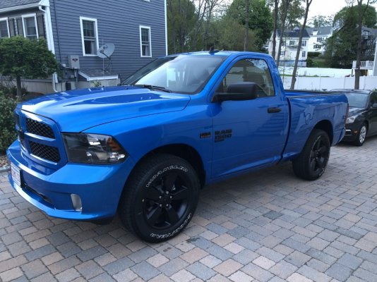

Hello I just picked up this regular cab 2wd drive hemi and want to do some mods. I want to drop the rear 2 inches and front inch. I know the 2 inch rear lowering springs are available. Does anyone make a 1 inch front lowering spring? I can’t seem to find a vendor. I am trying not to cut the oem springs . I am also trying to find this Rumble Bee Stinger graphic. Does anyone know a good graphics shop in Mass or Nh that can make it? Thanks

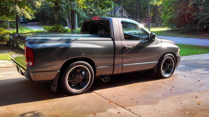

Not sure if you'll find a 1" lower front spring,if you want to only go 1" on the front,i think you'll be cutting your original springs. If you wanted to go to 2" on the front,you can get 2" drop springs,but you're better option might be to look into 2" drop spindles instead. You keep the factory ride and the truck will wheel align to factory specifications,plus it's way easier to swap spindles then springs. Springs are a bitchh to swap,and then you have to find an alignment shop that knows how to set the alignment with a spring drop.My truck is dropped 2" on the front using drop spindles,and 4" on the rear using cut down factory R/T springs,along with the early Illicit relocation brackets,you can see them on the rear,in these pics.

That blue will always be one of the coolest truck colors out there. Looking forward to seeing your progress!
