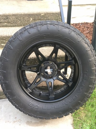

Hi all,
Need some help. I am going to look at a set of rims and tires this afternoon for my truck. They are 20x10 Moto Metal 961 with 35/12.5.20 Nitto Terra Grapplers. The seller was not sure on the offset.
Looks like -24 from the picture but not 100% positive.
My truck has Bilstein set at 2.8 in front and 0.75 TGC spring spacer in the rear. Will these fit my truck?
It's an hour and a half drive to pick these up, so want to be sure.
Thanks for any and all help

Not sure about rubbing, but is it the correct bolt pattern? Cant tell from the pics

according to guy selling them, it is for a RAM

Jack your truck up and try one on, last two sets of tires I sold on CL both buyers did that in my dway, didn't bother me a bit

That's my plan

I'd really want to know the offset before I headed out to test fit them.
A -24mm offset would work just fine to clear suspension and parts on the inside of the wheel well for sure.

I ended up getting the rims and tires. I sent him a text and he found the ET # and ....... -24. Now I need to have them installed and put my flares back on.ff0f298b09dd30f65e11580fc5e530d9.jpg
