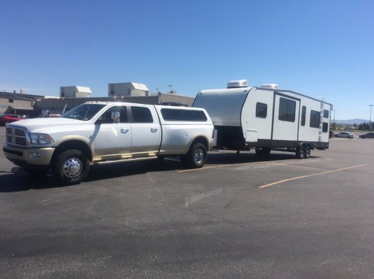

About a month ago I noticed my truck was running much hotter than it used to. I have owned the truck for 4 years and rarely did it ever go over 200. Now it seems to sit around 210. And quite often will go up to 220. I took it to my mechanic and they tested the fan clutch and stat and everything was good to go. I had them flush the radiator. We left for a big rv trip (approximately 3000 miles). And it's still running hotter than normal. What I notice is going down the freeway or even climbing big hills it doesn't over heat. But when we come to a stop and let it idle the temps will rise, or coming off the freeway to a stop I will see the temps rise.
I have heard many talk about blown head gaskets but wouldn't I have other symptoms especially towing 15k lbs halfway accross the country.
One other issue I have is when we stop and park the truck and idle (like when checking into a rv park or pulling over on side of road for bathroom stops) the brake and abs light and check 4wd lights will come on. After a couple miles of driving they turn off and everything goes back to normal.
Truck is a 2011 Ram 3500 dually 6.7 4x4

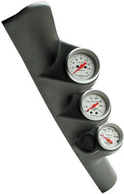

Do you follow your exhaust temps? If there is a problem with temps in a Cummins, it will show up there first. I drove a truck for a decade and had a Cummins as a personal truck, exhaust temps are a huge thing to visualize if you are worried about engine temps. A lot of guys who tow with a Cummins upgrade to exhaust temps gauge on pilar. Over on tdr they will say these pilar gauges should be mandatory.
Read here. truck trend exhaust temps.
I don't know what the 2017 has, likely you can get some of these through evic like trans temp. But do have boost or exhaust temps gauges?
