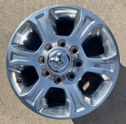

I have 2020 Ram 2500. I changed out the stock tires for Cooper Discovery AT3 XLT. I then notice my truck was shaking so I took it back twice. Come to find out one of my wheels is slightly out of round and the new heavier tire is causing it to be noticeable.
Can you believe Ram dealership wants $1200 for one rim!!!
Yes.... but do some shopping around. I found that prices varied (by several hundred) from dealer to dealer when I replaced my crappy "full size" spare with an OEM rim and tire.
I don't understand RAM's option packaging. I bought the heavy tow package. It included a "full size" spare on a steel wheel. "Full size" turned out to mean a tire of the same width, lower profile and larger diameter rim and practically no tread. The thing also had a lower load rating than the OEM tires. I could not imagine towing my trailer with it, for even 50 miles. What made the situation worse, two years ago nobody sold an aftermarket steel rim (one with six lug holes) that I could use to mount a matching 5th tire on. The only solution was to order a 5th OEM rim! Things have changed at Stelantis since they bought FCA. The last time I ordered a "full size" spare on an FCA product was on my 2005 Dodge Durango. I got an identical / matching 5th tire on a painted steel rim.

Did you verify it was out of round with your own eyes? Its certainly possible its out of round, but I would need to see it with my own eyes ...after ensuring they installed it on the balancer 'right' ...using the proper adapter.
I've literally stood right there and watched tire techs do the stupidest things when mounting & balancing tires, which includes things like installing the rim backwards, using too small of an adapter, using the wrong type of adapter, having something behind the wheel & adapter, Not tightening the screw down tight enough. There's a lot of adapters on modern tire changers, and some techs never master the basics. Have it checked on a Hunter Road Force balancer (the best), before you spend the big bucks.
I'd consider checking ebay for a used wheel during your shopping process, if you DO need a replacement. Make sure it doesn't come from the salty north...
