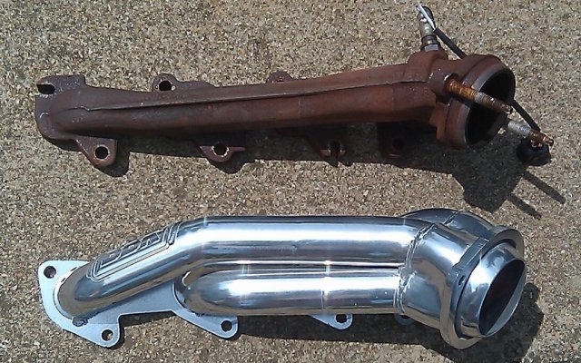

With decent enough headers the port mismatch will probably be negligible, or you could get 6.4 truck manifolds. Same shape/size ports. You are going to have a lot of fun (and spend some money lol) routing hoses and wires around making the 6.1 front cover work. Cheaper to machine your stock 5.7 front cover (or get the set and use adapter pieces to move the compressor and alternator out of the way. Then the 6.1 intake will just sit on there, you haven't screwed with your accessories much and all you need to do is convert to an electric fan (HAVE to, there is no way around this) and lengthen the TB wire. Scroll down on this page: http://www.inertiamotorsports.com/motors.html
Inertia has them, I believe Muscle Motors does as well. You can route intake however you choose, but this is similar to what you would get:

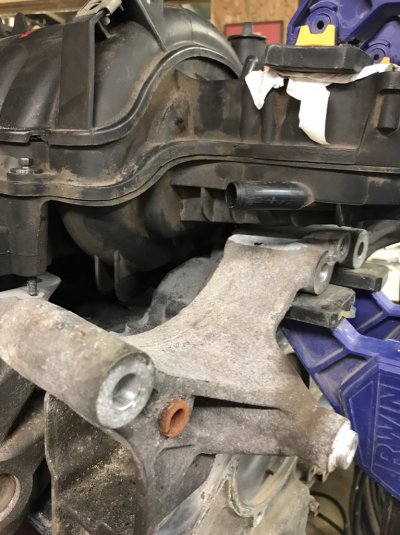

A member here did this. He made his own custom brackets ac739d3e7022dd87ab2b897d7e3b86f4.jpg
Here’s my timing cover I grinder down to fit an eagle truck intake. I still need spacers though. I’d go with a 6.1 manifold if they weren’t so damn exspensive 6a527e7e5f39b5ccfa01599567d06c24.jpg
