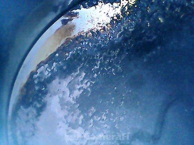

You can tell that piston top below pic is being cleaned in the right place, outside near and around the rings.
The best way to clean injectors is PEA detergent, redline si-1 and amsoil pi have the highest % of PEA, royal purple fuel additive honorable mention and the most popular is techron, I prefer redline, this is a ram forum members pic of cylinder top after running redline si-1. You can tell, it will likely need more then one, but you can also tell is cleans. The best time to run this is in the three tanks before an oil change, you don't really want to run this on fresh oil, this carbon doesnt just disappear, some of it ends up in oil and some gets burned out the exhaust.
This is combustion chamber yes, but PEA is the only thing that realy cleans injectors through the gas. Gas by itself is a solvent, so adding some random solvent which like 1/2 the cleaners do is only going to be so effective, you need a "detergent" and PEA is the known one for injectors.
