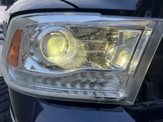

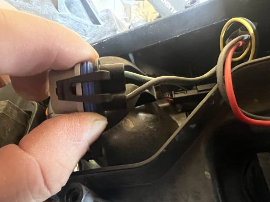

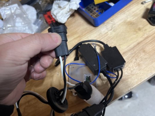

I’ll try running the ballast off the battery… need to find cables, garage is a mess lol.
They won’t ignite with the engine off either. Tried plugging them into the highbeam plug as well and they did not ignite with the high beam.
Pictures attach of headlight power output, HID power input, and overall lighting.
The kit came with additional warning eliminators which I’m not sure if they go after the ballast warning eliminators or between the headlight and HID power connectors.

Success. The secondary error eliminators sit in between the headlight power out and HID power in. So now it’s time to bust out the stepped but and put a hole in my headlight cover.
I appreciate everyone’s help and hopefully the troubleshooting steps in this thread will help others as well.
