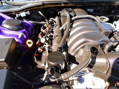

If you drain them hot,you shouldn't have to remove them,thats the purpose of the drain valves.My Moroso catch cans use the same 1/4 turn ball valves,and the secret to draining the Moroso cans or these cans is to drain them when the engine is hot,just after a drive. If you install a straight fitting on the bottom of the valve/s stick a hose on it long enough to reach under the vehicle and you can drain them into a catch basin.This is the Moroso can on my wifes 6.4 Challenger

I have a drain hose for mine. I get mainly watery oil mix every 1200 miles. Simple to drain into a oil bucket.
