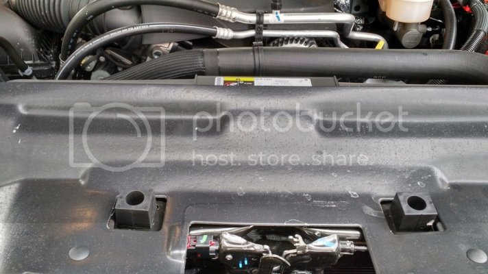

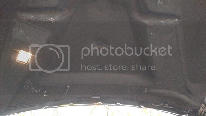

Well, after yeserdays posts, i decided to take a look under the hood and guess what i saw. Only a little bit, but im gonna have to watch it. Been a while since they replaced the nozzles and liner. Idk if its the right nozzle leaking (assuming it is). this is been a problem for a few now. I havent checked yet, but im wondering if the nozzles are the same as previous years cause never seen this mentioned before. If mine is leaking again, what are the chances of it being installed incorrectly. Possible recall???? Otherwise, its just keeping under my hood nice and moist and starting the rusting process sooner. Btw, I haven't used my washer fluid much since I had it roadies so......

Well, a liner shouldnt be stained after a few months of being built. I thought that the moisture was coming from the rain/or washing the truck, hence the title of the thread. A member pointed out that it had to be washer fluid from the substance that was on the liner. Could u imagine how bad it would look down the road. I know the liner doesnt afffect anything except sound), but if you were to remove it, you would be getting all that fluid on your engine. Even though its not much, it still can cause problems depending on where the fluid is going and how much (ie: an electrical connection). If others are having the same issue, it is most likely the nozzles. I can/will check it again when i get a chance. I see another visit to the dealer in the near future. I have already been there several times for this and my brake controller which still hasnt been fixed. Thats a whole other issue. This is unacceptable for a $50k truck. Although, I love the truck and its perfect for my purposes, I dont see myself buying new again and spending this kind of money when I can just get this kind of quality from a used vehicle.

Pull the tubes off the nozzles and see if tubes or nozzles have crap in them. I've seen a lot of plugged nozzles. I've seen plugged lines too but in much older vehicles that owners used who knows what for fluids.

I didnt need to use any paper towels, I took the liner down, lowered the hood just to the point of not locking it down, ran the washer pump for about 30 seconds, slowly reopened the hood and there was fluid on the engine cover and even a drop still on the elbow. I realize there are lots of ways a liner can get stained, but if you KNOW the washer lines leak, it just makes sense to get it fixed and not have a partially soaked liner up there all the time.
